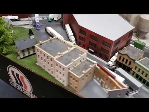

New to the site this evening, so figured I'd open up a build thread for my yet to be designed 3.0 layout. I am modeling the CSX Hanover subdivision running between Hagerstown MD, Hanover PA and Annapolis Junction MD, also including the YorkRail Genesee and Wyoming York Sub. I recently finished a home remodel that doubled my modeling space to include my entire basement ( half use to be 2 car garage. Thanks for having me and hope to meet the expectations of great modeling here

Welcome to the gang here Adam. You have a very impressive layout as we see in your video. I like your operating theme. I was in Hagerstown back in 2006 and remember the engine facility area looking a lot like your layout. They had a very nice model RR located in the old freight house then. Is this going to flow into the new space you've created in your basement? Or will it be dismantled and somewhat reassembled ?HO Scale

The layout was completely dismantled 2 years ago during my home remodel. Half my basement was a 2 car garage, which the remodel added a ground level 2 car garage. So once the basement was closed back in, I finished off that side of the basement, layout had to come down in order to finish the rest of the basement. Most of it is 2'x4' benchwork so it has been save and will be reused in some fashion during the rebuild. I have since inherited a yard that is on it's 3rd life now. It was originally built as Hagerstown with full round house, then it moved on to be Windsor St yard in York. The yard became available again after another real estate move so I gave it a new home originally intending to return it as Hagerstown. But I already had Hagerstown built, with the wye and cab tracks, which this lacked. I started looking at the arrangement and it struck me as a much better match for the old Western Maryland Lincoln Yard (now YorkRail/G&W), so now I'll adding some more of the York Sub to the plans, after having the PH Gladfelter paper mill in Spring Grove, PA on the old layout. here is a shot of now Lincoln Yard as I plan a few changes to better match the protoLast edited by Allen; 03-26-2023, 03:32 PM.
